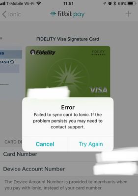

The Wallet icon showed up in my Fitbit app last night, so I went ahead and added my AmEx card. That worked flawlessly, although I haven't had a chance to actually try to buy something yet. I then went to add my Visa, but I had to wait until this morning to call customer service to activate it. It's now activated, but I can't sync it to the Ionic. Every time I try, I just get an error:
Syncing activity data and everything else is working fine, though. Interestingly, the card art for this card did sync to the device, but it's on the wrong card. I obscured the card number for obvious reasons, but the card number shown actually matches my AmEx, not the Visa.
I'm using the developer firmware beta, in case it's relevant. [Edit: the card art seems to have fixed itself, and I was able to successfully pay for something using my AmEx on the Fitbit. Still can't sync the visa, though.]

Hi @MarreFitbit, I think your list is outdated. When I first added the card, I called Fidelity to activate it, and they were aware of Fitbit Pay and were able to activate the card. If it weren't supported, I don't think I would have been able to add it to the Fitbit app in the first place.
More importantly, I did eventually get the card to sync, and since then I've used it multiple times to pay for things. The issue I was having was just with syncing the card. The workaround for card syncing issues seems to be to suspend and unsuspend the card, after which it should sync correctly.

@mlindgren wrote:The issue I was having was just with syncing the card. The workaround for card syncing issues seems to be to suspend and unsuspend the card, after which it should sync correctly.
Sadly not always and when it does work it tends only to be temporary. I’ve escalated the issue with Support but have no idea of resolution timescale.

Yup, you're right. I just went to lunch and tried to pay for something with my Ionic, but my card had disappeared again so I ended up fumbling around for my wallet and holding up the line. 😣
Please keep us posted on what support says. This issue makes Fitbit Pay unusable.
