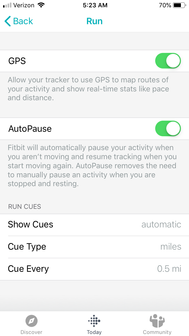

@ShimmyD First, I need to say that I have a Versa 2 on my account. I hope my advice will work as the two devices use the same OS. My firmware has been updated, but I was able to find the Exercise Cues in the app before the upgrade. From your app if you go to Ionic > Exercise Shortcuts > tap on Walk (or Run) > do you get a screen where you can toggle the GPS on/off and set the exercise cues? I am an iPhone user and I have this option. I can set my Exercise Cues there.
Definitely an app choice for me now.
If still not available, try going to your dashboard on your fitbit.com website > tap on the gear icon > Ionic > you can set the Exercise Cues there. But I just don't think it should be necessary.

Ok, so Cues is now called Laps and the feature is the same?
I assumed it was something different because the manual shows screenshots of Cues on the settings menu.
Thanks for the reply.

@ShimmyD No, Cues and Laps are not the same. I looked at the Ionic Manual, so I see what you are saying -- p 40 of the manual -- Cues are set from the Ionic.
Like I said, I use a Versa 2 and the Cues settings are in my app.
I do have an Ionic, but I will have to recharge it to put it back on my account to investigate.
I will get back to you on this.
Update: I charged my Ionic -- I was able to get into the Exercise App of the Ionic without putting it back on my account. When I select Run > Gear , the screen is identical to my Versa 2 screen. I am very sure you will find the cues in the phone app.
@SilviaFitbit Laps are not Cues.

Hey @ShimmyD. Sorry for the delayed reply. You have the option to set cues on your Fitbit Ionic or in the Fitbit app. When you're in the Fitbit app it will show "cues" but when you're setting them on your watch they will be shown as laps.
