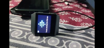

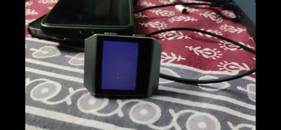

I am also facing same issue, after update my Iconic is blank, after reset it's ask for upgrade,againaagain completing 95% of software update the screen goes blank, it starts occassionally and complete the installation. Post completion it again ask for upgrade. Attaching the last three screen shots of upgrades.
