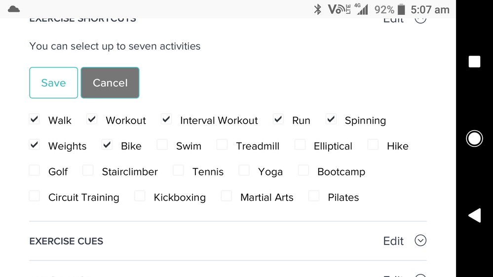

05-22-2020 13:34
05-22-2020 13:34
I went through the process of your instructions again. Once I chose the activities I wanted, I had neglected to hit the save button. After I did that and went to the GPS section, walk was checked and said GPS on. My error, thanks for the help. It is working now!
