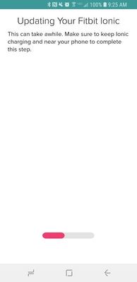

I've been trying to upgrade my Ionic to the 2.1 version of the OS without any luck. It sits on the "Connecting to your FitBit Ionic" for about 5 minutes, then asks me if I want to retry, then asks me if I want to restart Bluetooth, then asks me if I want to try over WiFi. It just seems to do this forever but never actually updates anything.
Things like daily steps are sync'ing perfectly fine. Is upgrade just broken? Or perhaps is there another way to upgrade, such as over the USB cable?

Thanks! So, when I go into the "WiFi Settings" on the app, it just spins forever at a blank screen. The WiFi says off on the Ionic. I know I've configured it before, but maybe the settings were lost. I tried on a few different WiFi networks, same problem.
I did reboot the phone and Ionic, and now Bluetooth seems to connect. However, it spent about 20 minutes upgrading. Then the watch rebooted and went back to the phone screen, but the app stayed on the "Upgrading" screen from then on. I waited about 10 hours, no change. Seems totally hung.
Perhaps the factory reset is worth a shot.Sat here for 10+ hours
