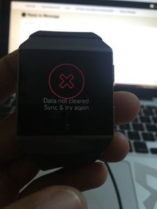

Hi @RicardoFitbit I did the reset with the steps indicated above. However, now I am getting a black screen with the message "Data not cleared Sync & try again". However the Pulse Ox light is not as bright as before. Any tips?

Thanks for trying the troubleshooting steps that were shared on my previous post. Your Ionic is displaying that message because the firmware update process wasn't completed. That said, I recommend you to learn more about how to update the firmware version of your Fitbit device with the information that's specified on this help article. Then, please move forward to the troubleshooting steps that are specified on: Why can't I update my Fitbit device? and let me know how it goes.
Let me know how it goes.
