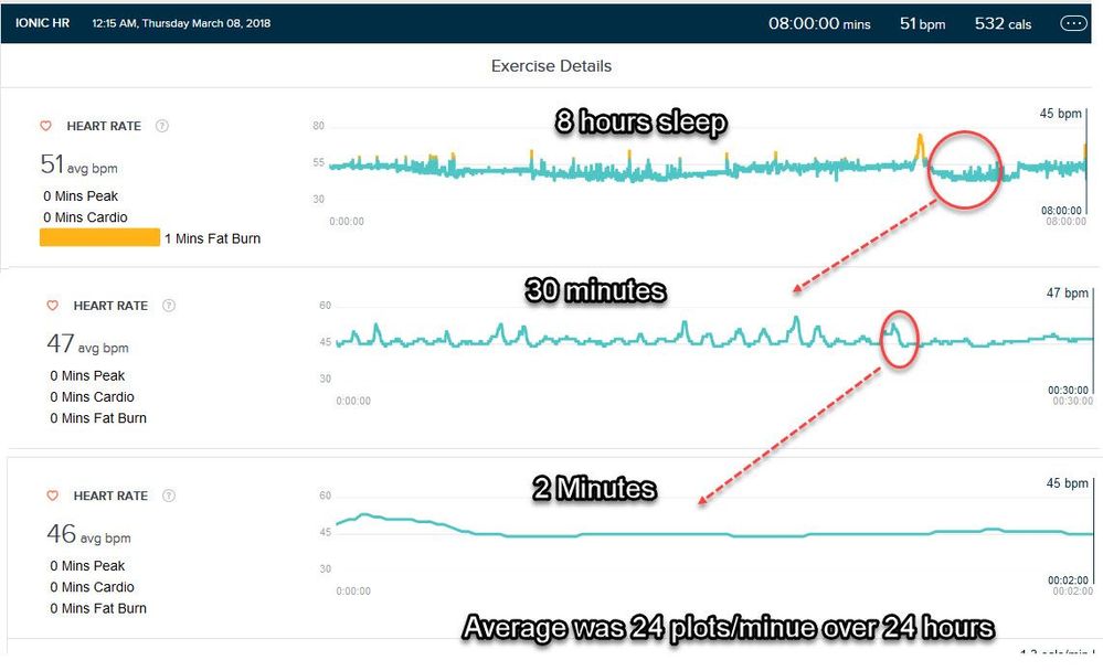

@Wood1eIf your watch is showing an active HR you should have data. What have Support suggested.....?
Currently Fitbit is recording approximately 24 pulses/minute. If your watch is syncing to your phone you could try something..

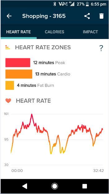

When you swipe right to left from your clockface, do you see exercises ?.. Does workout show up. If so tap that and start it.. I use that for many things to record the HR.. Let that run for a few minutes, stop it, see what shows on your watch.. Then sync the watch and you can then examine the results on the Exercise tile .
This will help you get to a solution.. Here is a typical image on the phone with a renamed 32 minute Workout...

@Wood1e.. Here is one of my sleeping graphs... No exercise there.. All I do is setup a Custom Activity.
But before, that does your Exercise App on the watch have the "Workout" ?
Because your Ionic is tracking and it will have up to 30 days of data before it casts of the oldest day before you sync.. Important that it's showing your pulsing HR..on tjhe watch....
Here is the graph...
No exercise there..... I have a missing heart beat... All ok, and I try to pick it up.. But the end result is my average sleeping HR...

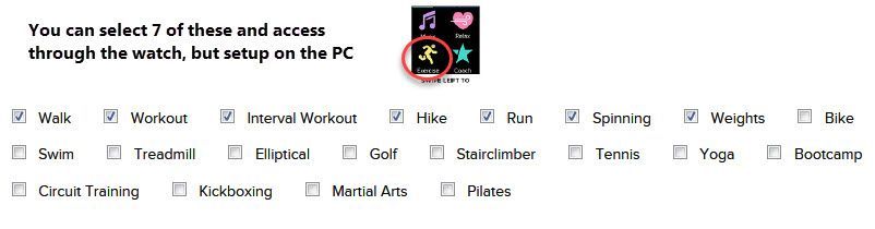

You have the exercises here and manageable through the PC..some of them have GPS and you can turn that off..

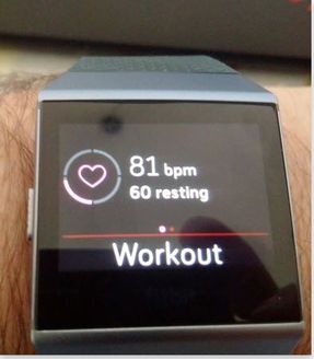

From the Clock face swipe right to left until you see the Settings gearwheel, tap that and you should see some of this and then swipe up until the Heart rate shows.
Tap that and it toggles from On to Off, then push your left button to return to normal and see if the lights are there...

I turned it off where you said but that just shut down the Heart Rate monitor.
I started again...this is what I see when I swipe down: https://screencast.com/t/EErje41P
Just the Heart Rate

What you see now can only happen if the HR option is ON.. Also your RHR will not show on the watch if your HR gets into the fat burning zone (FB) and above. The circular graph advancing into each zone until your HR gets below the FB zone.
When you swipe right to left on that view you will eventually see a vertical RHR of the last 7 days.
