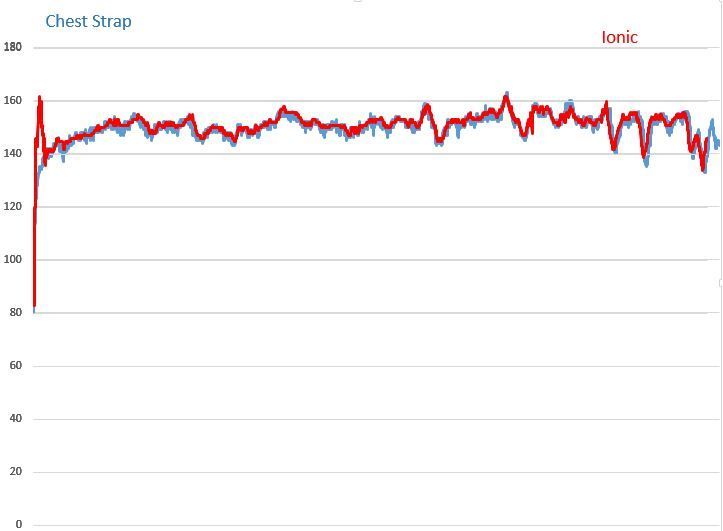

Hmm... measures fine. Chest strap (blue) vs. Ionic (red). The graph is over a 11 mile run... Sometimes it glitches right up front (worse than seen here, but even the chest strap has glitches) but that is only if I fail to wear it properly and it settles down shortly. There's a slight delay from the chest strap (pretty standard given the location differences), but it's been pretty solid. And I've tested it compared to Wife's finger SpO2/HRM sensor (for her asthma), and it's rock solid.
Not sure how Fitbit can "fix" something that seems to work for many of us.

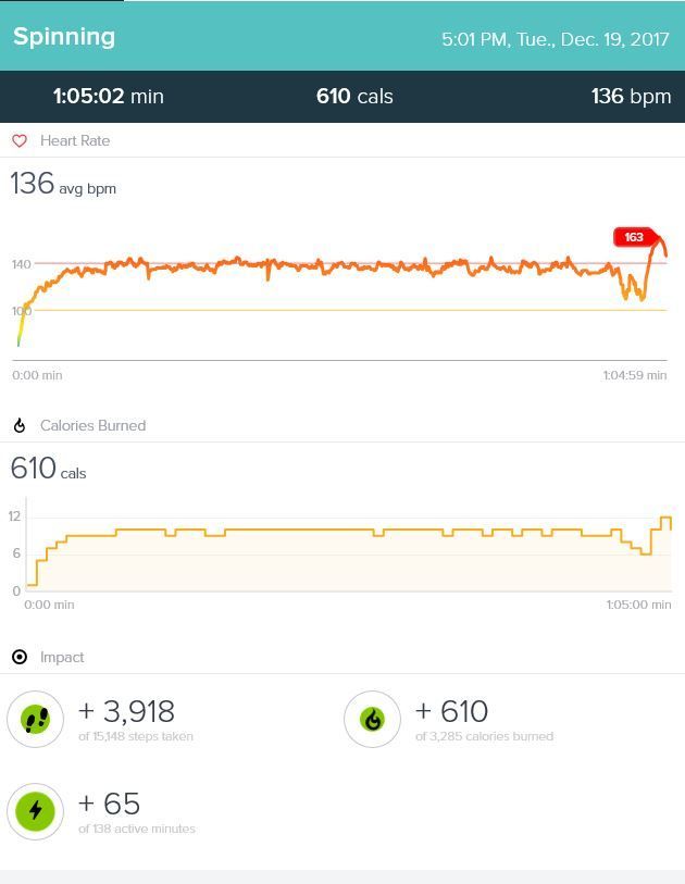

Again, I did a test on my spin bike again, with Ionic fairly tight on my wrist. It worked great all the way. Steady spinning at 70 rpm with heart rate 130 to 140. When I pedal without resting my arms it shows 140 when resting arms and upper body it is 130. It was within 2 bpm from HRM on my spin bike.
The 164 bpm is a sprint at the end. No creasy 208 at all.
As you can see it assessed about 3,900 stepps/spins. Not bad, only 10% short from actual. This is calculated from small wrist movement, even with hands on handlebars. Amazing.
Looks like it goes crazy only when I'm running. Rest, walk, work, sleap, most other exercises is working great. I'll try to reset it before next run on Saturday. We'll see if it helps.
