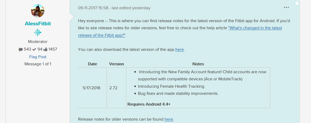

@MattFitbit, Just saw this in the Android App forum. Could this fix some of the issues with the Ionic we have all been experiencing? Just saw this in the Android App forum. Could this fix some of the issues with the Ionic we have all been experiencing?
