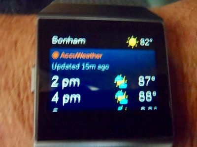

No issues with weather App, it is showing current data even though wifi is off (Ionic not charging)

Same as me. But, again, my weather app is updating if not connected - yours?

@Rafster83 by design, it seems that Fitbit designed Ionic to only use WiFi for downloading music, apps, and firmware updates and loading music.
I agree with you that Ionic apps *should* be able to use either WiFi or BT, however at this time it seems apps must use Bluetooth to access the Internet.
ahhh, makes sense. Yeah, has to be bluetooth because if my phone isn't with me I'm not getting notifications either.  Not sure I'll need realtime weather app updates for tomorrow while running, the predictions cover the rest of the day and me and my mobile will find each other by day's end to catch up.  Wouldn't expecting realtime wi-fi on the road be sort of like buying an extended network plan with a phone carrier or are we simply discussing while in range of connected wifi which would mean your phone is probably close anyway? Getting confused.  Good discussion!
