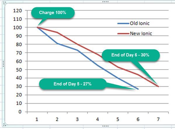

I have turned off the "old ionic" at 27%, 5 days after the triple restart.. The replacement Ionic, because of no GPS, is now at 30% at the end of 6 days with it's first initial charge and OS2 update..  A sleep tonight so I will at least get 6.5 days..wearing it 24/7. Similar to day 1 of my firat Ionic last October.
There is an improved gradient on the replacement Ionic
Colin:Victoria, Australia

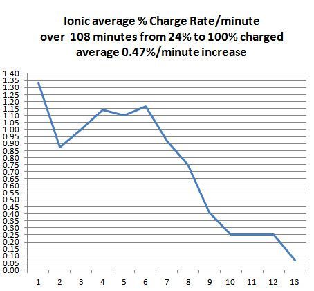

This is my 2nd Full charge on my replacement Ionic.. I got 6.5 days from the first charge and recharged at 24%.. He is the charge timing and %/minute average of capacity over the charging time to 100% from my USB port on the PC.  The last 25% took 60 minutes or 55% of the charging time.
Since that charge, in 6 hours including a 32 minute workout, the Ionic is down to 97% which is my typical battery use 0.5%/hour during daylight with 5.6k steps and 57 Active Minutes...
