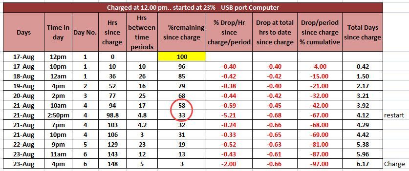

I shouldn't have posted here because it has spooked my Ionic.... The last 2 weeks at about the 3.5 days and the battery at about 58%, the Ionic suddenly discharges within 2 hours to dead flat... Once while watching TV, another 30 minutes after I went to sleep. and the third yesterday.. It takes about 80 minutes to charge to 100%.
The discharge rate in those first days averages 0.47%/hr. I have done as requested, charge after a factory reset and yesterday after 3 restarts.. and after 24 hours, the battery is at 90%.
Over this journey I have been emailing Support and the last email is below and now I'm awaiting an answer about the sudden discharge. I have always used the USB port on the computer and now they want me to use an external source.. So now I'm waiting for the battery life to decrease still further because in Australia we now have 2 years warranty from Fitbit. Rather than the 3 months I have left from the original warranty.
"We appreciate your time and effort providing us your details. In line with this, we'd like to explain that the Fitbit Ionic battery can last up to 5 days depending on several factors that affect the battery of the watch, that includes: screen wake, applications, alarms, heart rate, etc.
Moreover, it looks like your tracker’s battery life is in the expected range for your type of tracker and the frequency at which you use features that impact battery life.
Furthermore, we recommend to kindly try an alternate power source".

It's nearly a month since I posted about my sudden discharge at about 4+ days after a full charge and that has only occurred once since at 5.33 days.. At the start of this period I did a 3 consecutive restarts on the Ionic.
In this month the Ionic has averaged 6.55 days and charging from an average of 14% remaining. I get the low battery notification at 25%.
Whether the 3 restarts of the Ionic triggered this stabilization I don't know.. or... my gut feeling something goes rogue within the logic of the Ionic and flattens the battery suddenly as if being used.
I still have an escalated case outstanding where Fitbit want me to send my Ionic to the local distributor to examine the battery..but only when this rapid discharge occurs again.
I have not changed any settings, so still 24/7, sleep works, all notifications and alarms are active. Manual awake and no "All day sync". The Ionic is set to "Always Connected" and the Fitbit One, that option is turned off. I manually sync the Fitbit One when its steps exceed the Ionics steps. No GPS over this period. Just some Workouts.

@BldemI don't know about a fix, but in the middle of the rapid drain, have you done a restart...Also the 3 consecutive restarts helped me..
After my post on the 16th August, the very next day I did my restart during a sudden drain, see below, I got another 2 days.. So a 11 days after that meltdown the Ionic is at 47% remaining and at 3.5 days..
I documented my issue with continuous emails to Support and finally they had enough documented evidence to replace my Ionic.. It's on its way now. Here is the link to Support and depending on what time it is you either get the choice of a phone number or email..
Here is an example of my documentation.. I'm well retired, so I have time to document this and over the years I have found a positive approach with supporting emails goes along way to a resolution..
Qualifying this, I have my backup with a Fitbit One (obsolete) in consecutive Multi Mode so if the Ionic crashes suddenly I still have my steps.

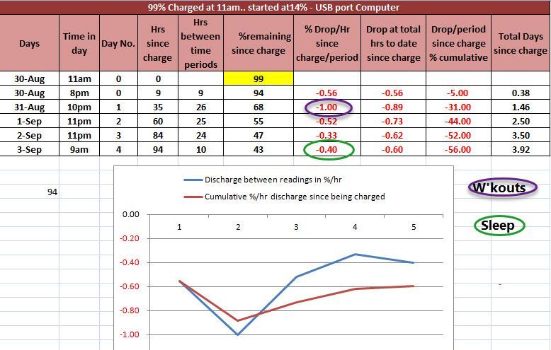

@MattJ71 We definitely have to be aware of all possibilities. Last night while asleep my Ionic only discharged 4% for 10 hours which is normal for a non active period.. and, from the image you can see when I do some workouts (no GPS) and these were only brisk walking, it dropped 26% for the daylight hours. .. You will notice the time differences between my recordings and I don't worry to much because my trusty Fitbit One always syncs my steps and floors in my multi mode.
I can't pick the random, spasmodic discharge.
Because the Ionic is tardy when it syncs I noticed yesterday the battery dropped 2% while syncing nearly a waking days data. Now, for the first time ever this mornings sync, the Ionic switched off.. needed a restart, and that also dropped 2% with only 10 hours data and a restart.
I have held off posting this and in 1/2 hour it's dropped another 2%, now 41% while typing and breakfasting...
My replacement is due in a few days from Fitbit Support via Amazon. I have the delivery emails etc.. So we will see how that performs.
