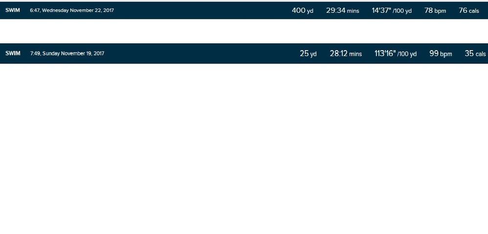

So far my results suck with ionic in open water. Hate to report, all my fellow swimmers are looking for devices for xmas and keep asking about my results, and no one is looking at or now interested in getting an ionic at this point. Too bad. For all other activities I am very happy with it, I use wallet, starbucks and all the activities and sleep app. But if you are looking for a swim tracker and only swim open water, then this is not the device to spend your money on. Hope they (fitbit) fix this someday.
I am not an expert but my observation is simply add a linear option as "length". It obviously is not counting strokes, so it appears not to be using an accelerometer. So how does it track swims? I tried asking fitbit support but they appear to be clueless on technical information. All the seem to be able to say is the problem is conditions. That has to be BS because conditions and length have not been a factor in my results. I have examples of "pool" flat calm wave-less neutral current to severe chop wind high swells and currents pushing back. No difference in the tracking. If this was an accelerometer why not just track strokes and have a setting for stroke distance (similar to steps).
I have many examples of the inability for the ionic to track open water. Here are two recent ones.
Two recent examples, Sunday the 19th and today the 22nd. Both swims similar distances, about 1800 yards.
Sunday was windy with very choppy with 1 to 2 foot swells and a strong current strong with us (north). I set "length" to 25 yards.
Today the conditions were calm and as flat as any pool would be. Not a ripple. Less of a current but still
north (with us). I set the length to 100 yards to see any difference.
As you can see ionic is not able to track anything well except the time (manually started - from the above posts I will try the automatic method).

My understanding is that for laps, all vendors use the accelerometer to detect turns at wall. So for lap swimming its counting the number of laps, and getting distance by multiplying lap count by pool distance (the distance you set).
For open water my guess is other vendors do a lot of GPS data smoothing, because when arms are moving in and out of water that will generate a lot of "noise" in the GPS data (bad data when arms in water).
