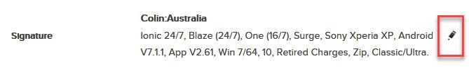

@SunsetRunnerGreat that you're spreading the word about signatures.. It would save a great deal of angst if we knew more about a postee.. Many probably aren't aware of how to include a signature..
Just click on their Community profile image, then click Profile, then.... just hover over the Signature area and the edit pencil will appear.. When done, just click Update..
Colin:Victoria, Australia
