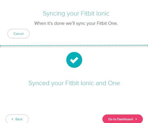

Over the years I have found all of my Fitbit Bluetooth products get confused with too many Bluetooth devices in close proximity to a sync.. I have always had success with Fitbit Connect with a BIG but.....
I have just tried to sync via Fitbit Connect on the Windows 7 PC as I'm posting this and it gave up trying to sync.. Fitbits couldn't be found... I turned off Bluetooth on my phone and an immediate dual sync.. Fitbit Ionic and One..
Also a trap is when you have multiple computers in the house, for example a Windows 10 with Bluetooth and you have been attempting to pair there.. That caused me some grief a few months ago and I had to unpair there..

Here is the Windows 7 Fitbit Connect.
Also
