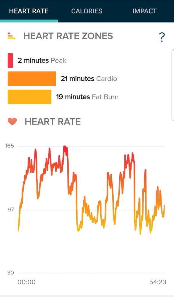

This is on a basic walk around our neighborhood with no hills or elevation.
