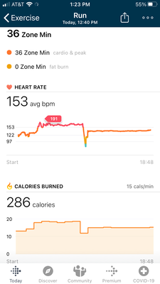

I have had two Ionic’s and in both cases the HR monitor does not capture the right rate until I am well into my run or walk. It initially goes way too high, 170-190 almost immediately, then it “snaps” back down minutes later to a normal rate 140-150. Sometimes I can take it off, put it back on while running and fixes it. Very frustrating and it seems to be getting worse.

I wear my Ionic on my left wrist, top of wrist. I usually snug it so that it does not move excessively when exercising.  I notice this usually when I walk or run. Usually at the beginning, but not always. The Ionic ramps quickly to a very high HR, then after minutes it will snap to a lower HR. Sometimes I can take it off while running so that it loses my HR, then put it back on and it will go to the correct rate.
So an update on this. I shaved the hair from my arm where the watch sits, just to see if it was better. It worked fine on my 5k today, so will update if that result is consistent for the week.
