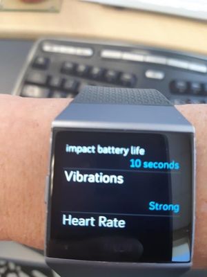

Hi there, First thing I would do is remove the device from your bluetooth settings and re-add the device, and then this is what I did to get my notifications working.
Step one: press and hold the left and right bottom button simultaneously till your screen flashes, this refreshes the device.
Step two: hold down your left hand side button until the below screen appears then turn your notifications to 'on'.
Step three: when you screen is at your main menu where you see the loaded apps exercise, alarms, music, etc you will see the settings app, click on this.
Step four: scroll to you see the vibrations option - i have set mine to 'strong'
Step five: scroll till you see the 'Notifications' option click on this.(please note this is different than in step two).
Step six: once you have clicked on the 'notifications' option you get three choices for the notifications, i have ticked all three - see below. Once this is done if you want to go back to step one and refresh your devices - fingers crossed you will start seeing your notifications.
