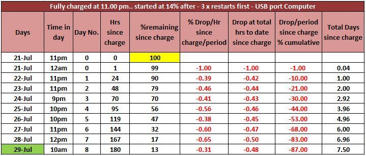

Success.after the 3 successive restarts before charging a few days ago.. The Ionic is at 13% after 7.5 days and now being recharged. The this full charge will be the litmus test and it's recharging at 1%/minute while I type this..
The image below shows the discharge rates/hour

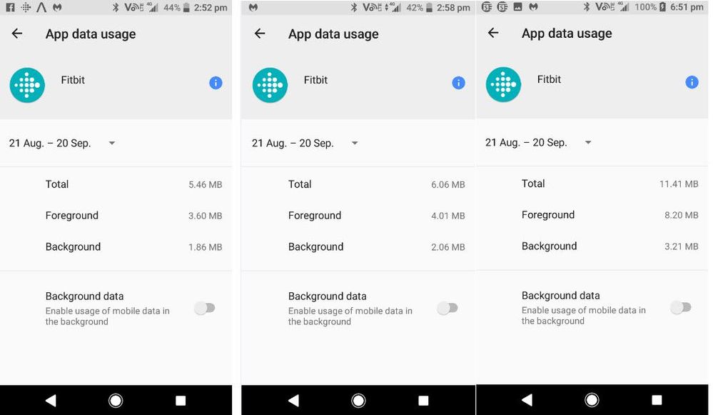

It seems to point to operating system issues because I have also monitored the Background Mobile data issue which "leaks" when the Fitbit Background option is set to Off...  That doesn't seem to be aggressive since our melt down a few weeks ago.
Mobile data usage with Background data OFF.. as a percentage of the total of the Android Mobile data usage
Period
21may – 20jun        7.8%
21jun – 20jul           34.1%      when we had the Fitbit meltdown
21jul   - 20Aug         8.2%
21aug – 21aug      19.6%   Not enough data here and that is now 17.6%...dropping..
Today's data usage  and it's the start of a new monthly billing cycle.
Colin:Victoria, Australia

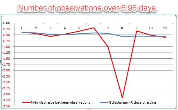

Nearly 24 hours on since the Ionic restart in the middle of a battery meltdown and the discharge rate has remained constant.. Now at 25% and 5 days and the low battery warning. At this rate I will get at least another 24 hours.  No top up charging.
I will continue testing this because...... if a simple restart arrested the battery meltdown at about 4 days it is definitely pointing to something in the OS
In the graph the Green cumulative discharge rate hardly gets a blip because of the averaging. but the periodical logging shows the drop.
