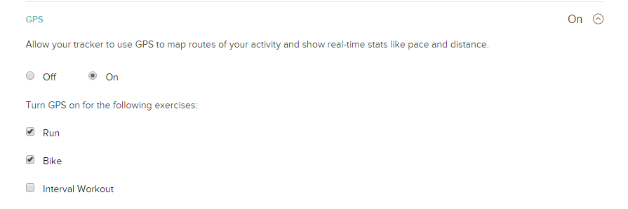

@Chingyq Thanks for your reply! Please try these workarounds:
  • GPSGPS
This should help you out!
Try that out and let me know how it goes! Smiley Happy

Hi, this method did not work. I still have to wait for 5-8 mins for a lock on.
@Chingyq, if you restarted your Ionic and followed the steps that @SantiR mentioned, and it still does not connect with the GPS you probably need to contact Fitbit Support so that they can determine if you have a defective Ionic.  Mine almost always connects to the GPS in 30 to 60 seconds, which I think is probably normal.
