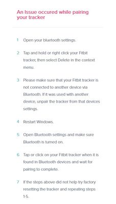

Trying to set up my device in the app:
An issue occurred while pairing your tracker
Tracker:
Check settings:
Bluetooth on
Tracker not listed
Manual add to Bluetooth:
It is not recognized by Bluetooth. Bluetooth searches and searches, never finds my tracker. (It’s sitting right next to my laptop spinning away at the “Get Started” notification!)
Bluetooth off:
Insert wireless sync dongle and click “Start”. Returns me right back to the same screen regardless of how many time I click start.
It does not recognize the wireless dongle when attached. (The dongle is connected properly to the tracker and to my laptop.)

@ArcticCatXF8000 may I ask what type of phone or computer are you using to setup the tracker? Yes as you realize seeing the setup message means that the tracker has been removed from your account and needs to be setup again.
Have you removed the Ionic from your phones Bluetooth settings, or maybe the command is to tell the phone to forget the ionic.

Hi Rich,
I am using a Toshiba Satellite laptop with WIN10. My "phone" is not in the equation. 1 laptop, 1 Ionic, that's it. When I search for a device in Bluetooth, because the tracker is not listed as a connected device, it does not find my Ionic.
Should my Tracker be stuck at the "Get started at ~fitbit.com/setup" stage? It WILL NOT go past that point.

Until it is setup, yes it will be stuck on the setup page.

The only way to get the ionic setup message off the screen will be by doing the same steps that was done doing the initial setup.
Your doing a factory reset removed the tracker from your account.

I simply said that you will need to do a setup of your ionic. You chose to do a factory reset which removed the ionic from your account.
Did you buy a Fitbit dongle? Does your Toshiba have built in Bluetooth? If it does you will need to turn it's Bluetooth off when inserting the dongle.
When you say that no Bluetooth device can see the ionic, your only interested in the Fitbit app setting the Ionic, your phones Bluetooth may not see it, and can not do anything with it even if it can see it.
