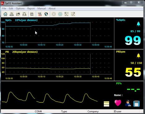

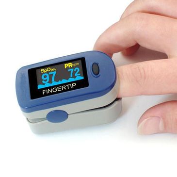

@StarryAtari I'm like you, and running is not for me... 80 next birthday. But I have tested Fitbit's Cardio Score against my Pulse Oximeter ($60). I gave up waiting for Fitbit to release their SPo2 feature. I like to know if the Fitbit results are valid..
My RHR has averaged 54 for the last 12 months and moving between 51 and 55, my sleeping HR gets down to 41... and my weight ios stable and the SPo2 reading moves up and down by 1 point over the year..
I like to know what my baselines are, and fortunately I'm genetically born to have a reasonable oxygen uptake. as measured by my Cardiologist Cardio stress tests. On my last test the specialist asked me if I felt OK because he wanted to keep the treadmill test running longer to analyse how/why my body was uptaking extra oxygen.. in the end... Genetics.
The images below show that the Cardio score and my Pulse Oximeter score equates.. THis deviced links to your computer via the USB cable and stores your tests.
This link gives you more information, and I have done the Rockport Walking test and it also backs up Fitbit's Cardio Score.

I've been thinking about getting a pulse oximeter with USB data - what kind of information can be determined using data from the chart on the bottom of your computer screenshot (the one that looks like it shows your rhythm and perhaps strength of beat)?
