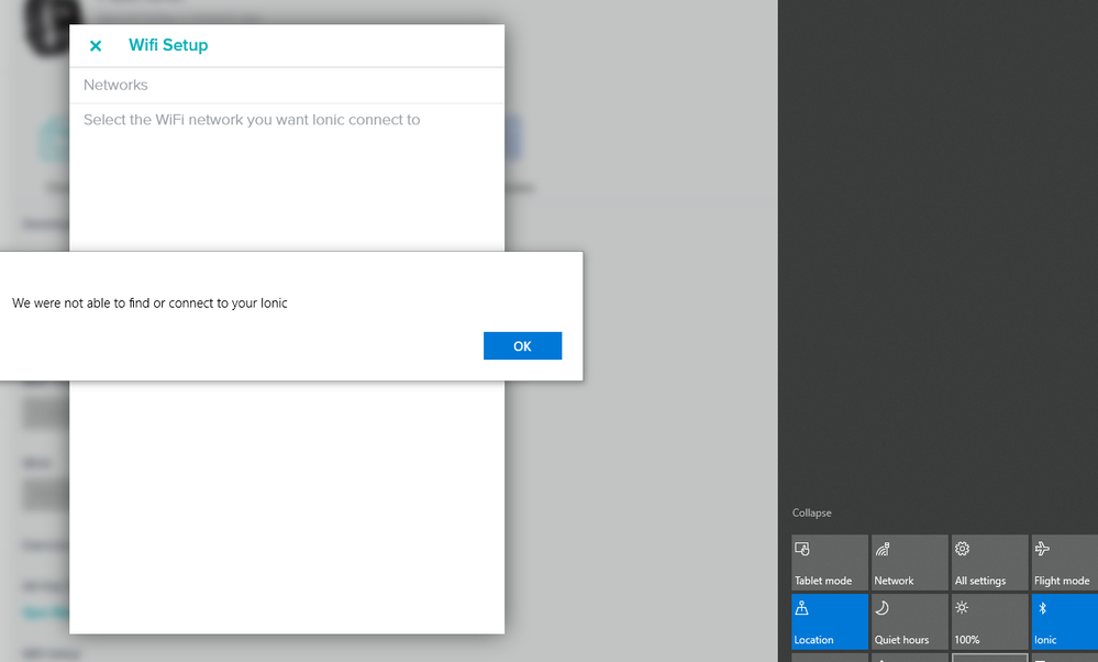

There seems to be more problems with the bluetooth and detection. Look at the screenschot: the Ionic is paired and connected, but the Fitbit App cannot find the Ionic.

Best Answer10-01-2017 16:35
10-01-2017 16:35
@RHAD Our engineering team has noticed an issue where Wi-Fi turns off while trying to select your playlist for some users. I'll let do some more investigating to see if there is a workaround for this. Thanks for your patience and for the screenshot.
