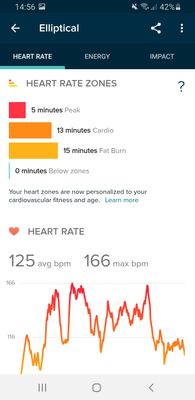

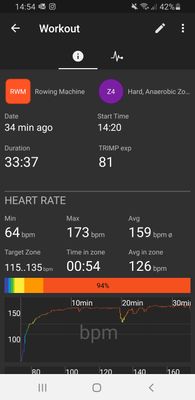

 Here is a direct comparison of the same workout with my Ionic and my Garmin Dual HRM chest monitor. Pretty shocking really.
