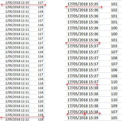

Over the last few months I have been enjoying a download of 24 bpm/minute and suddenly we are back to last years plot points of 7 bpm/minute.
For those using HR download, have you noticed this difference. ?
I have double checked and reloaded the same data of a week ago and it still had the 24 plots/minute. So it's obviously a current restriction on the Fitbit site.

I'm using the Squash League site and download from there. The image shows the difference in data downloaded. I downloaded the earlier data to show that the data had in fact diminished.
I also checked some GPS HR downloads.. on the GPS portion HR 2 days ago 6 plots/minute HR
On the 22nd May 38 plots/minute GPS period, and 22 plots/minute sleeping.
I'm plotting my sleeping HR to examine my missing Heart beat (all ok'd by Cardiologist etc). It drops to 44, then picks up a couple of beats but the Fitbit data is still too coarse for that..
I'm not concerned, it was an experiment to see what was possible, but there has been a change..

@bbarrera Here is a sample of the GPS HR data, before and after

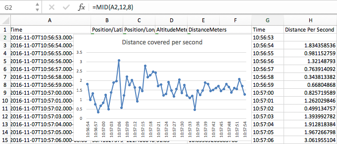

Instead of trusting Squash League, you should do it the "fitbit way" and the easiest way is to do the following:
- track a GPS activity (because oddly enough, Fitbit only allows easy exporting if GPS tracked)
- download the TCX file using web browser, from fitbit.com (find activity, then click details to open a webpage, something like https://www.fitbit.com/activities/exercise/1111111111)
- rename 1111111111.tcx to 1111111111.xml
- convert to Excel, for example using this randomly selected web tool http://www.convertcsv.com/xml-to-csv.htm (change name in "Save your result" field and download as Excel)
- open 1111111111.xlsx
- now you have columns for time, latitude, longitude, altitude, heart rate, etc.
- make a new column using formula "=mid(a2,12,8)" to extract the timestamp
- change column formatting to time
- plot

@bbarreraGreat information... Works like a dream, and I used the Convert to CSV direct and got my 60
plot points... That's the way us retired engineers think..
I will let Squash League know.. and sadly the TCX HR result only works effectively for GPS tracked HR.. On my heavy workout, even though it allows TCX for non GPS nothing was forthcoming.
Thanks again this will help many because it was so simple.. I didn't have to rename the TCX file, it converted it.
Best Answer05-21-2018 17:23 - edited 05-21-2018 17:48
I gave exact procedure but left out some steps that failed.... the real reason for renaming .tcx to .xml was to attempt importing XML directly into Excel (Excel was being picky about extension). That attempt failed, because Microsoft didn't implement xml importing in the Office for Mac OS X version. If not for that, I would have tried using online conversion tool with .tcx.
