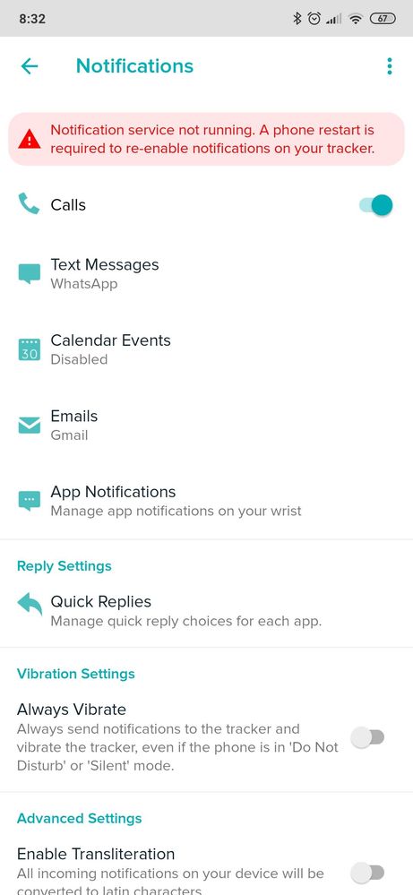

I have a notification problem.
I installed the app again, I restarted the phone and ionic several times, but I could not solve the problem. I only see calls on my ionic, but no notifications from whatsapp etc. any other suggestions?

@fdemirsoy It's nice to see you on the Community. Thanks for the details mentioned and the troubleshooting tried.
I would like you to make sure you're doing this procedure to set your notifications. If you are but you're still not receiving any other notifications other than calls, please try the troubleshooting mentioned in this article.
Also, I would like you to let me know the phone you're using.
Keep me posted.

Thanks for your reply.
I tried also the troubleshooting in your mentioned article but its still not working.
In the app notification is this warning:
but after several restarts nothing changed.
I found this article https://community.fitbit.com/t5/Android-App/RESOLVED-06-16-2018-quot-Notification-service-not-runnin...
but still no solution.
I'm using Xiaomi Mi 9t with the app vers. 3.13
Best Answer01-23-2020 22:17

@fdemirsoy Thanks for the troubleshooting tried.
Regarding the issue you're experiencing with notifications on your Ionic, we’re aware of it and are working to identify a resolution as quickly as possible. We're sorry for any trouble. We appreciate your patience and look forward to getting you back on track.
