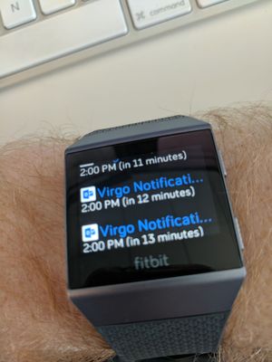

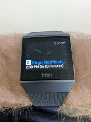

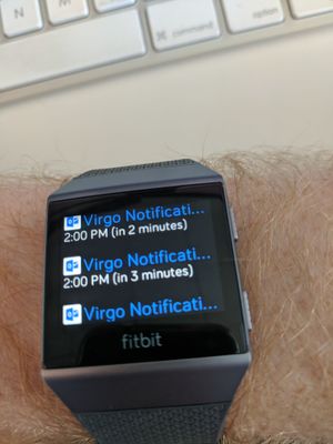

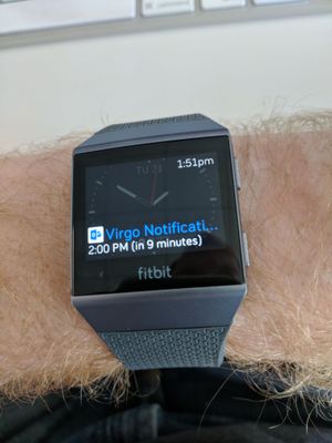

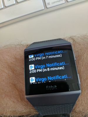

Outlook notifications badly broken on Ionic (Outlook calendar notifications, Android)
I really want to love my Ionic but the biggest feature I was hoping for in my smartwatch is an interactive calendar / agenda in addition to notifications and other information without consulting my phone.

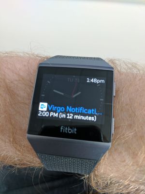

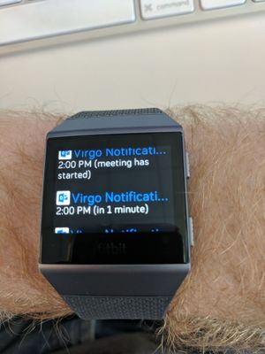

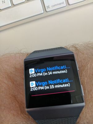

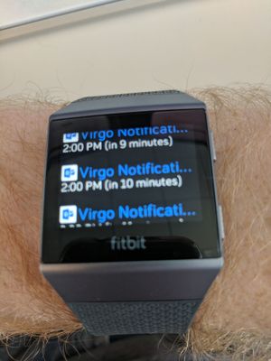

For some reason Outlook isn't recognized as a calendar app but I was hoping to view the notifications on my Fitbit. Unfortunately notifications are badly broken when using Outlook and possibly other services. In the notification Outlook shows how many minutes until a meeting, and fitbit seems to think every minute is a new notification so my wrist vibrates every minutes, 15 times, before every meeting. I can't disable the time in the outlook notification and I can't get this to stop without disable notifications all together. It's frustrating enough that I'm close to giving up on the ionic but I'm holding out hope there's a solution.
Has anyone found a way to use outlook calendar notifications? Can fitbit be smarter about the notifications it's sending to the phone? Any help would be greatly appreciated!

No, I have a Google Pixel. The notifications will work with other apps too, I think the biggest issue is outlook puts a "(X minutes until...)" in the notification. When that timer updates the notification is resent to the fitibit and I think the ionic should behave better when forwarding notifications.

Outlook updates the notification each minute and it get sent again to the smart watch.
