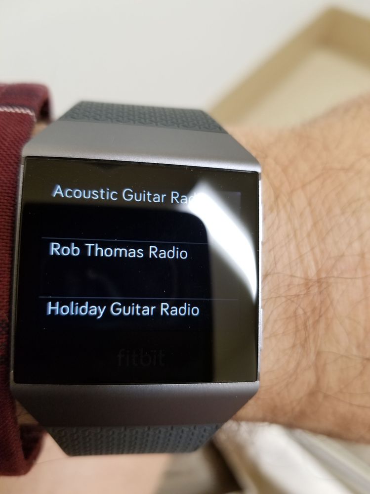

After initial issue with the transfer of music from Pandora, got 3 stations I wanted. Want to remove a station and replace it. I deleted the station on the Pandora app and have been playing the new station a lot- like 5-6 hours with my “new” station streaming on my Echo with the watch on the charger. The “old “station has not disappeared from the watch, and the “new “ one hasn’t showed up. I realize there can only be 3 stations.
Can’t figure out why the deleted station from the app continues to play as one of my 3 stations. Help/ explanation appreciated.

@LongRunNick I hope you're doing well! In which Pandora App did you removed the station? You need to do that from the Fitbit App. Please do the following steps to manually add or delete stations:
Please check this article for more details on this.
Try that out and let me know how it goes! ![]()

Thank you, I guess I should have been able to figure that out. Actually what I did was keep streaming the station I wanted with the watch on the charger and it finally worked. Your solution seems easier and way less time consuming. Thanks again. Nick
