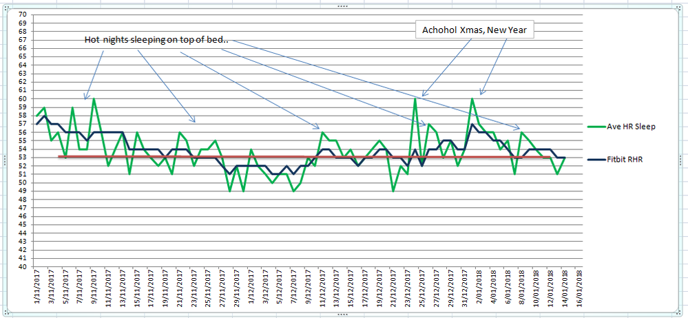

It's very important that you wear your tracker while sleeping. I have found it has a significant impact on RHR.... The HR while asleep mirrors the RHR on the Ionic Fitbit stresses this in their help offerings...
