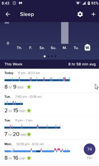

Suddenly my sleep stages have stopped recording.. The old Sleep graph is there.
The heart rate is recording on average every 6 seconds and I have checked all of the steps as recommended by Fitbit help. Including restarting, full battery etc. battery is at 59% now.
I'm awaiting Android App version 3.9.1 in Australia but I have never had any issues over the last 12 months with my Ionic syncing and recording. The battery lasts 5+ days etc.
The HR graph equates to the wake times etc on the Sleep graph so it cannot be intermittent missing HR.

No changes, battery is at 50% and Sleep stages worked perfectly today.

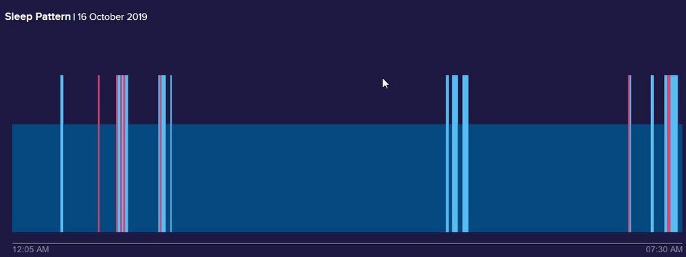

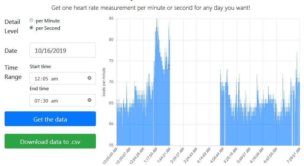

I went back through my sleep logs and on the 16th October found at least 3 hours missing.. even though the sleep log showed me as 6hr 45m
Parallel to all of this I had a major operation on the 14th October and released from hospital on the 17th October. You will notice many nanny naps since the opweration but only one failed Sleep stages as above until October 30th. I went to the hospital with a fully charged Ionic and as at writing this my Ionic is down to 23% after 5 days.

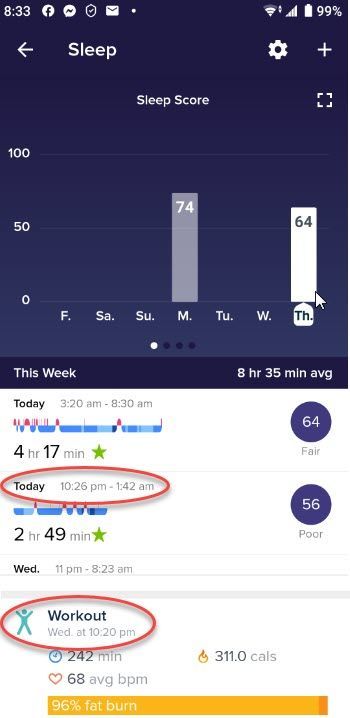

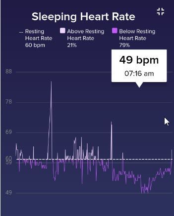

@LizzyFitbit I have just done some more research om my historical data and analyzed 8.3 hrs sleep from the April 1st Sleep Stages data, and there was not one gap in the HR collected data other than the typical 5,10 and 15 second gaps.. The average HR pulse data point was 6.9 seconds
So I then started a Workout Exercise between 6-24pm until 9pm this evening, where only 517 steps were recorded. A typical, eat your evening meal, read and watch some TV and getting up for kettles etc..take the dog outside and check some emails.....
The results were an average of 2.09 seconds per recorded pulse and only one greater that 1 minute and that was at the very start while the Workout was feeling its. way.. Otherwise the variation was between 1 and 3 seconds, hence the typical average from a Workout...
So theoretically if it were watch contact issueswith the wrist while asleep I will start a Workout when I go down to sleep tonight and log the sleep when I awake. I have done that before..

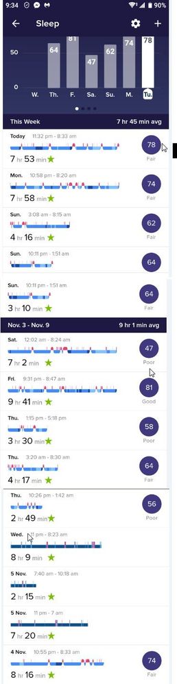

@LizzyFitbit After last night it gets more confusing as to why the Sleep stages work sometimes and not others. I even searched through old posts about the red and green LED's from underneath various smart watches which had vague answers about Red being needed for sleep..
Here are last night's results and the 4 hour Workout period and the parallel Sleep period had perfect results.. No missing pulse gaps on the Workout and the sleep which would be logical.
I happened to wake and realized there was 4 hours of Workout there and synced to get the Sleep Stages.. Had trouble getting back to sleep, but did for another 4 hours to gain a total of 7hr 6m Sleep stages. The final sleep stages had 17 gaps of pulse from 27sec to 2m15secs. So that isn't the problem.
This all feels like I'm at the GP's... "come back tomorrow and we will do another blood test"...
Obviously some explanation on how the sleep tracking works when the historical posts talk about Sleep Apnea, SPo2 etc and the red LED's..and HRV while asleep. I understand HRV because I have my own device for that.

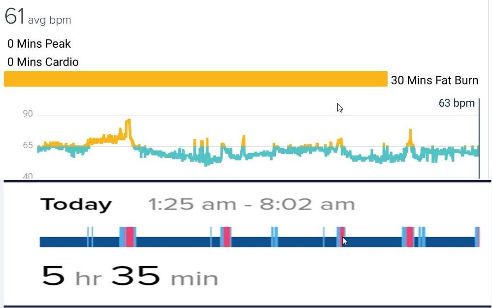

@LizzyFitbit Another interesting result this afternoon.. The weather was dismal here today so I went down for a nanny nap.. This became 3 x 1+ hrs and I woke each time at the 1hr period and synced the watch.
There were still gaps in the HR so I must discount that as the issue.. So I'm now more confused than ever.. So we continue to monitor...

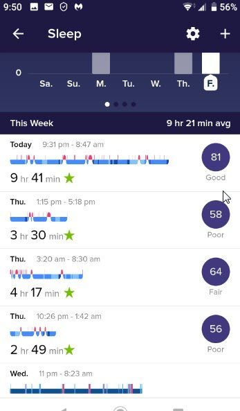

@LizzyFitbit I must have needed the sleep.. Probably delayed reaction after my operation.. Phew, 18+ hrs in 34 hours elapsed...
Last night, I had another positive result. Each time I woke up to go to the bathroom I synced the Ionic. The Sleep stages again started off with the Classic old sleep graph, and, eventually after the 3 hours Fitbit produced the Sleep stages..

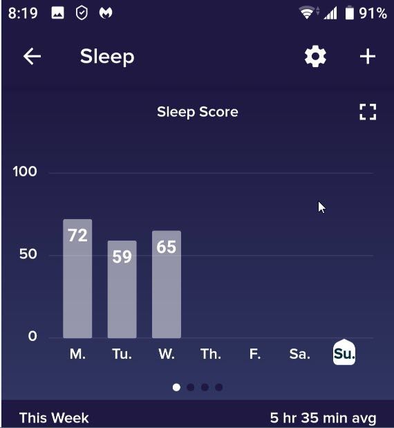

@LizzyFitbit Thanks for getting back...The error has stopped.. A week of normal results..
I never had any real issues since the Sleep stages were released but I notice in other posts there may have been some adjusting with sleep stages during my period of issues. Being a very retired IT man I can understand what can occur.
It hasn't missed a beat.. A few nights ago even the automatic stitching of 1 hr sleep modules became the correct sleep stages result. A couple of disturbed nights where I had broken sleep but the stages were all over 3 hours.
My sleep analysis is what I expect.. All genetic with me.

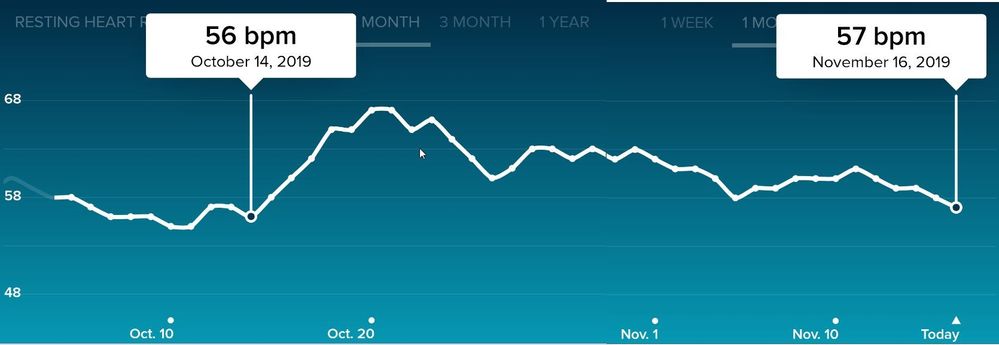

LizzyFitbitThanks again... I'm glad the stages are back to normal.. It's been 10 days now and I'm happy it's mapping my bodies progress after my operation.. Now just over a month (Oct 14th) since the op and Fitbit's detection of my bodily changes are being reflected.
Very comforting...

Hi @Colinm39. Hope you're doing well!
That's awesome news! Thanks for sharing that with me, as well for the screenshots. I'm glad you're also recovering fast after your operation. I'm sure at no time you'll be back rocking all your steps! 😎
In case you have some spare time, I’d like to invite you to visit our Discussion Board where you will find great tips and encouragement from other members and if there's anything else I can do for you, please keep me posted!
