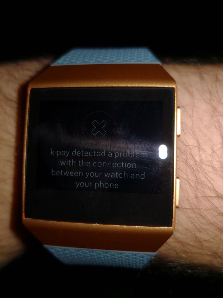

Hi,
After a few happy days of using my Ionic, and some notification issues with Huawei Mate 10 pro (works, but notifications works on/off), a New problem decided to find it's way to my phone/ionic.
K-pay detected a problem with...
This message is i possible to X out. And after restart of Ionic it comes back right away. I also stoppe reciving sync/notifications. Tried uninstalling app, reinstalled.
Remove bt sharing
Tried setup again, hets a far as "found it..." and i can enter code. AS soon AS i do, k-pay decides to say hello again, and everything hangs.
Also worth mentioning, i live in Norway and no pay/wallet functions are supported.

This is a very weird problem with the ionic. Fitbit always have something to surprise you, don't they?
You can try as a last resort to perform a factory reset on the tracker, though this will erase all the information of the tracker and you will have to set it and update it again.
You can look for the instructions here on the forums.
@Skyggen I'd bet $20 that you installed a 3rd watch face, and that watch face requires payment for continued use after a trial period. Fitbit doesn't support an app payment system, and some developers use KiezelPay.
Reset back to factory defaults and you should regain control of your Ionic.
Hi there, I had this issue and rather than reset everything I just went onto my phone and picked a clock face that had worked previously, hey presto it worked 🙂 🙂 🙂
Resetting the face to an fitbit face stopped the k-pay from popping up. Thanks!
