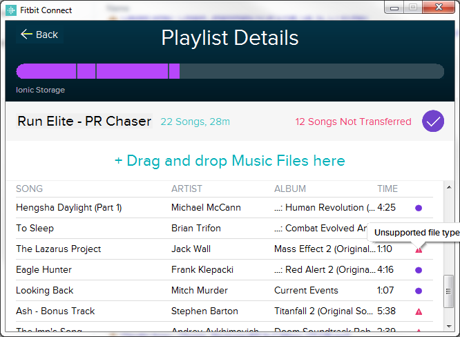

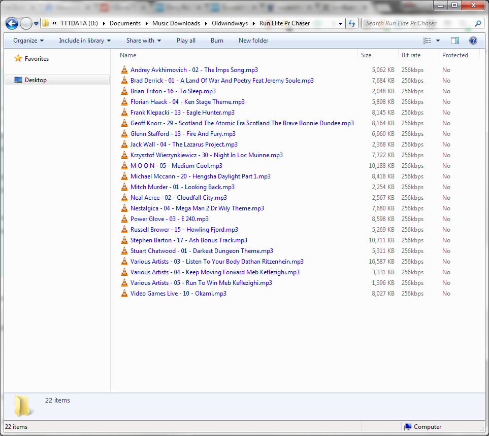

I am struggling to successfully upload a complete playlist without running into problems. I am able to connect to my Fitbit Ionic most of the time from my Windows 7 laptop (running the Fitbit Connect application). I have 4 playlists on my PC that I have tried to transfer to the Ionic, 2 of which have been successful. The other 2 have only been partially successful for example with 10/22 songs being transferred, with the remaining 12 songs being marked as "Unsupported file type." despite being the same mp3 format as the other files, the same 256kbps bit rate and not necessarily larger than those files that were successful. Playlist in Fitbit Connect
These are files that are saved in a directory on my laptop and I created the playlist in the Fitbit Connect application using the drag and drop option.
Files in Windows Explorer
Why are these mp3 files being marked as unsupported when they are indistinguishable from those that are working?
Additionally:
- Is there a way to re-load a playlist from Fitbit Connect without removing it all and reloading it? The current method is inefficient and takes a long time for anything but the smallest playlists.
- Why is the Fitbit Connect application stuck with such a small window that cannot be resized? There is only room for a playlist of 8 or 9 songs before you have to start scrolling.

@OldWindways You pretty much have to either remove those files (DRM protected, most likely), or figure out a way to get them (legally) into a non-DRM format.
The MP3 files (or pretty much any music file) have metadata associated with them, containing stuff like the artist and more, plus some DRM (Digitial Rights Management - mostly copy protection) info.
If you have the physical CDs, you can just re-rip them, and that should set you up with non-DRM tracks.
If they were downloaded, you need to check back, and see if there's a newer (possibly non-DRM) version available.
There are "other" ways to change the DRM state, but most are marginally legal, at-best, unless you know you have rights to change them.

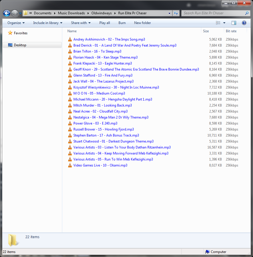

@PeteG-1, I don't believe those tracks are DRM protected. Here is the same directory showing the "Protected" property is No for all the tracks.
MP3 files showing No DRM Protection
Unless there is some other way of checking for DRM protection, it would appear that this is not the root of the problem.

@OldWindways Weird. I bet there's something different about the format though, or some "bonus" metadata, that's confusing the FB app.
It's not exactly the most robust music app I've seen in awhile, you can see my comments above ;-]
The thing that I find puzzling is that the app does zero in terms of error-handling, or reporting anyway, it knows it was unable to deal, or chose not to deal with those tracks, due to some property, why don't they log/report it...

Has anyone figured out the "unsupported file type" issue yet? I've worked as an audio engineer and it boggles my mind what distinguishes what is supported and what isn't. It doesn't seem to have any relation to name length, metadata, bit rate, sample rate, stereo or mono, special characters, file size, or song length. Basically, it seems to be completely random.
This thread looks like it has been going on for years and this asinine problem is still going on!?
