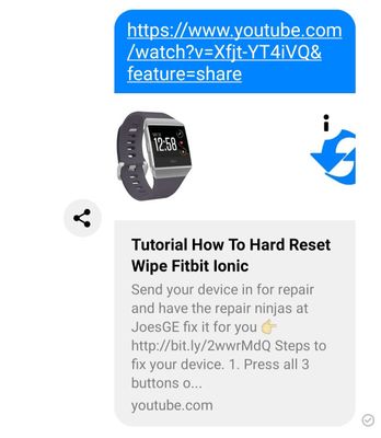

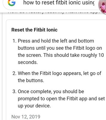

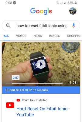

Pla follow the steps on youtube (fig below) as well steps below it. It solves mine, i hope it will on yours.
and this one below

Hi,
Would like to send the youtube video, as to how hardware reset your fitbit ionic. However, its not possible to attach it here.
Together with the video is the steps on how to do it.
You can enable the PIN for fitpay upon resetting and synching your fitbit to your smartphone.
Anyway, here are the steps frm the video and you can repeat it several times if possible. Pls give me your email add so i can send you the video.
Thanks be safe.
Best Answer05-08-2020 22:55
05-08-2020 22:55
Hi again,
Here is the url add of the video
pls inform me if it works.
Regards
