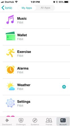

I'm in Singapore. This is what I see from my Fitbit Ios App. All my account settings have Singapore set up as the location.

Mike, did you mean the settings icon which should be on the right of the Wallet app? If that's what you mean, I don't have that icon. As you can see, the Weather app has that settings icon on the right.
