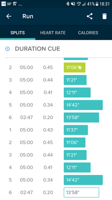

Was wondering if something is up with my watch, or if this is a bug.
*Situation

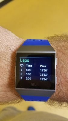

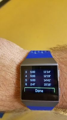

I go for a run at the Rec Center on the indoor track. I start the "Run" exercise with GPS turned OFF. I go for my run and it tracks as it should. I finish the run and when I finish it shows me my post-run stats. It also breaks down each 5 min interval as a lap. On the watch, everything displays as it should.
When I go look at the activity in my Fitbit app, the "laps" have tripled. I have attached pictures.
Any ideas?

I have the same problem when i run on the treadmill the laps are like what you have shown. The laps are either double or tripled. The only think that i did was turn off the auto cue until there is some fix.
