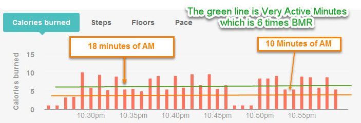

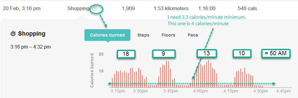

@mttroublemakerTo add to @NellyG post fitbits Active Minutes are defined as 10 continuous minutes at a minimum of 3 METs, (3 times your sleeping/resting calories (BMR)). In the graphs below, which you can create by using the Activity Record Icon (Large stopwatch) at the bottom of your PC Activity Log screen or your browser on your phone.  See this link for definition
This is a pure copy of your data and doesn't affect anything.  Occasionally you will see 9 active minutes included in the count
You can create a manual record for the exercise and that levels the calories burned over the time period and you may then get 100% Active Minutes... The downside is that that activity will not go towards Challenges, steps etc..

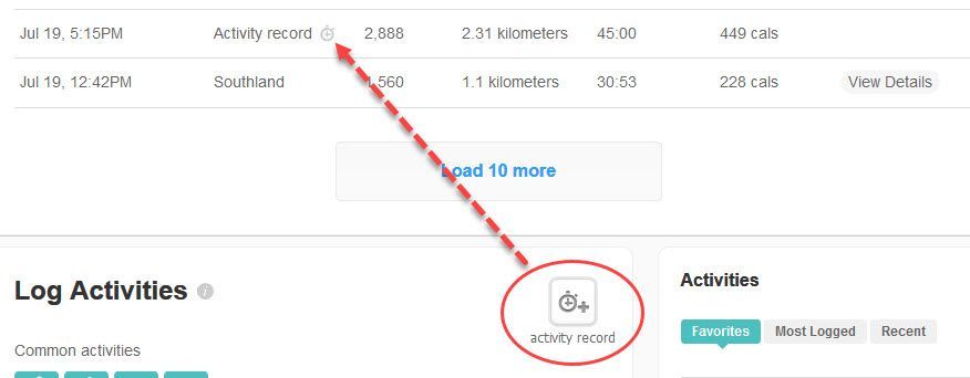

@mttroublemakerThanks for getting back.. If you create the Activity Record in your browser Activity Log that will give you the answer.  Look at the calories..  You can also edit this record.. Excellent tool for analysis
  • Go into your Activity Log (Browser)
  • Click on the Activity Record Icon
  • Enter the start and end times, ensuring the date is correct
  • Then click on the small stopwatch next to the description
  • You will then get graphs similar to my earlier post
  • Then examine the calories for active minutes.. 3 times your BMR
  • If unsure of your BMR use this calculator which uses the same equations as Fitbit and divide the answer by 1,440 minutes/daya.  Only 5 calories/day different for Fitbit than my BMR
