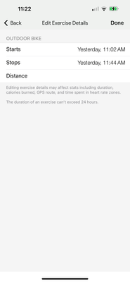

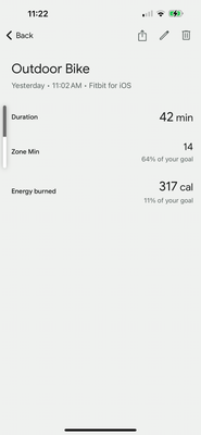

I have the same issue with the app on my iPhone. I can no longer edit the exercise type. The 3 dots are not there to edit. As like others, the pencil only lets me edit start, end, distance. I was actually snow blowing, so walk would have been a closer exercise than it auto selecting Outdoor Bike. I definitely wasn’t moving that fast!

Really? Not that I can see.
