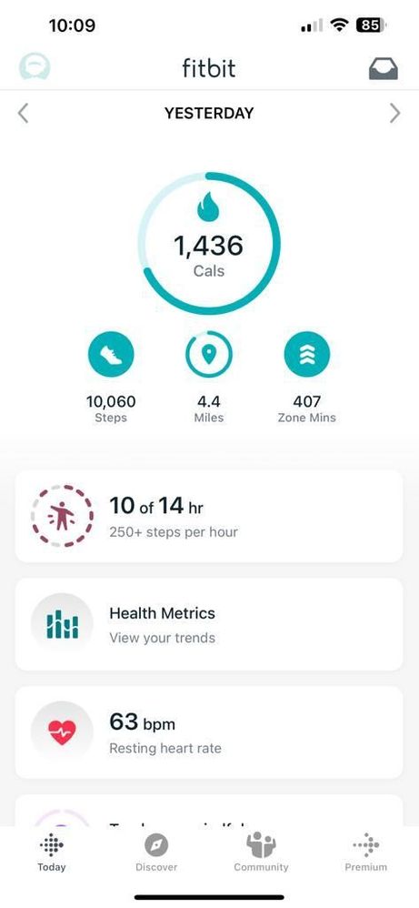

Hi All,
One of our user's Luxe device is showing Zone minutes even when the user is not really active. Please find the relevant screenshots. Let us know what could be the issue here and how this could be fixed.image1.jpegimage0.jpeg

The issue is the zone ranges itself. If you see the attached screenshot from the user, the Fatburn zone is from 86 onwards, which looks wrong. Attaching the zone categorization for this user whose RHR is around 63.

Hi @LZeeW , we've found the issue. The user's DOB is somehow set to Jan 1st 1900 and the user's age is calculated as 123. We've asked the user to update the dob and the zone categorisation is correct now.
There should be a default way of calculating zone minutes if the DOB looks wrong or not set. Not sure how many other Fitbit users have the same problem and think that Fitbit is showing wrong data.
