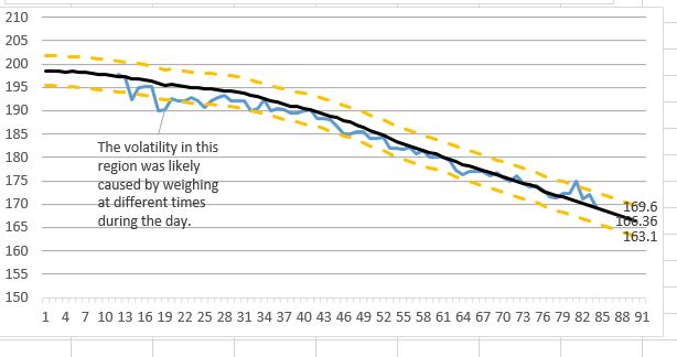

Along the way, some suggested it would take a lab to settle the matter. First, there is the problem of counting calories consumed. Every study I've seen referenced people estimating calories on a plate set in front of them. These estimates are worthless as they vary widely. However, manufacturer's labels and nutrition content online for fruits and vegetables are fairly accurate if a person weighs all their food. If a person eats a variety of food, they are likely to be accurate enough collectively.
Last year, I did a scientific level test as I lost about 30 pounds. I counted calories as accurately as I could, and I measured calories consumed using the Fitbit Zip. We all know the Zip is going to be wrong, but it will be consistently wrong  as long as the exercise profile doesn't change during the test. For instance, if a person took up bicycling during the test, all bets would be off. My exercise was walking and lifestyle steps.
I found it took 2,789 Fitbit Zip calories to lose a pound. This doesn't say the 3,500 calorie standard is incorrect. What it says is the Zip may measure consistantly low. Here is a graph of the results.
experiment.JPG\
The black line is the expected weight predicted by the total calorie deficit. The blue line is the actual weight. The dashed yellow line is a 97.5% confidence interval meaning 97.5% of the time my weight would fall between them.
After 84 days of testing, the actual weight was 169.6 pounds and the predicted weight was 168.9 pounds. The difference is about the weight of a good bowel movement.
It's not in this chart, but the R-squared, which is the percentage of change caused by the independent variable is 0.97. The independent variable in this experiment was total calorie deficit. The dependent variable was weight. 97% of my weight change was explanable by the calculated calorie deficit. The other 3% was other factors.
I'm running a similar test this year using the Surge. The weight loss constant appears to be about 4,000 calories/pound vs. 2879 calories/pound for the Zip. This is because the Surge says I burn more calories than the Zip. My exercise profile has also changed.
Anyone can run a similar experiment to test the accuracy of predicting weight loss through the calculated calorie deficit. If you have any questions about setting it up, ask here or send a pm.

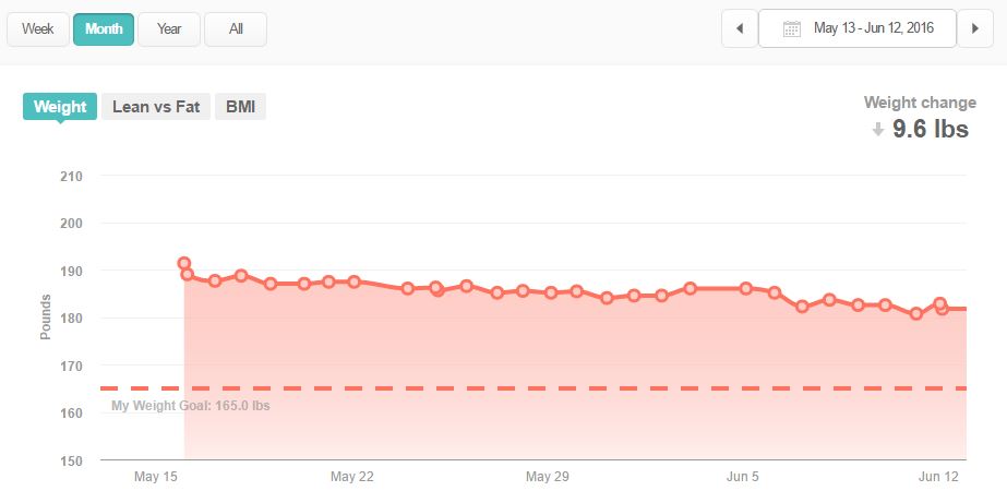

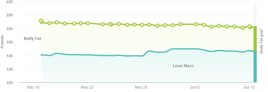

I know people like to see real numbers in a discussion like this. The information was recorded by my Aria scale. It's hard to see from the chart. I went from 191.3 to 181.7 pounds.
The mysterious part is the large gain in lean mass. There are at least two explanations. The first is the scale is wrong. The other is an extremely low fat diet affects lean mass. Since another user reported the same gain in lean mass at the same time, I tend to go with the explanation there was some sort of update for the Aria. The argument against this is my other scale shows the same lean mass gain.
Ocham's Razor would suggest saying the increase in lean mass happened. I'm reserving judgment until there is more data.
