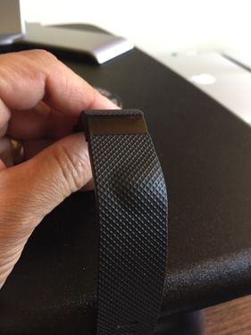

An air bubble has appeared on the strap of my charge HR. I follow care instructions on my band. I'm gutted as I've only had it since Febuary. Has anyone else had a similar problem?

I totally agree Fitbit messed up on this model and has fixed it by coming up with a replaceable band model, The Charge 2
Here is a fix I have done for this model.
I tried the super glue fix and it has worked like a charm.
Use a good quality super glue like Loctite or Dap Brand.
In my opinion, Fitbit used a evironmentally water based brand. Darn stuff lasted less than a year for me.
https://m.youtube.com/watch?v=oTOINaksZek

Here is a fix without super gluing the band.
Just pick up some heat shrink tubing from Home Depot or Lowes in the electrical department.
You need a blow dryer or heat gun for this fix.
I haven't tried this fix, but leaning towards it if the super glue I applied starts letting up.
At the moment, the super glue fix works like a charm
 https://m.youtube.com/watch?v=Mi1lYoUTcDU

That bubble is right above the battery vent hole. I would put a small pin hole to relieve the pressure if I t was mine. When I charge mine, I only go up to 95% of the full charge and only charge it once a week. I wait until I get the email to say charge it soon.
I've always said the battery needs to vent when it is charging.

Yes! I got a bubble the first day out hiking on a hot summer day. I tried a pin head and relesed the air but it Stays up - will not go back down flat 😞

Yep! Same thing happened to me. I have a blue one. They said because its 14 months old. They would only give me 25% off my next one? I lived with it that way for a few week now. Now the bubble got bigger the whole width of my Charge HD. The new issue after playing with a wet dog for an hour. The seam all the way across (above the LED display) came loose. It's supposed to be splash proof. But they cannot take the heat and moisture at the same time. I had a black one last year that had to be replaced because it had charging issues for a v1 or v2 charge HD model. I was happy it was replaced, but not happy that a newer Charge HD now only lasted 14 maybe 15 months. I will not recommend this model or but a new one. When this one dies or the super glue job. I'm going try doesn't take. I'm done.
I kept wearing mine. Tried to ignore it. Now it's falling apart even more. My bubble was just like that one -it got bigger. Now the top part has a small bubble and the seam came loose from the display edge.

Get your super glue bottle out if your warrenty has expired.
Just did a friends Fitbit at work and he was impressed how well the super glue trick worked.
