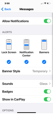

I had this issue and then it resolved and then I stopped getting alerts on my Fitbit again. I didn’t get notifications for about a year until I did more digging. If I remember correctly I went to Bluetooth forgot my Fitbit and then re-added it. Usually when I mess with it I would restart my device. I also went into my settings on my iPhone and made sure that on the notifications for messages that everything was turned on. Going into the notifications is what fixed the issue I’m pretty sure. I hope this helps.
