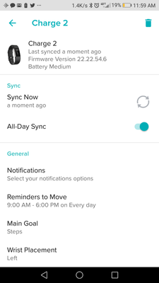

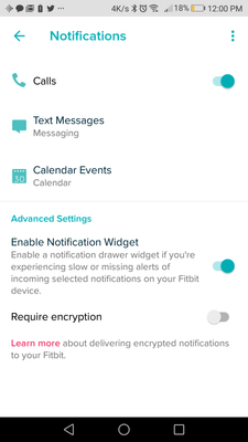

08-22-2017 12:07 - edited 08-22-2017 12:13
Here's what my notification settings are. I made sure to have the Fitbit widget always active... I don't know if that has helped with the stability or anything. But I have been getting text and call notifications for the past few days on and off of WiFi.

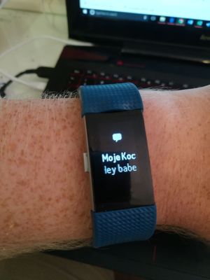

08-22-2017 12:10
08-22-2017 12:10
Here's a text that I got from my wife that showed up just a bit ago
