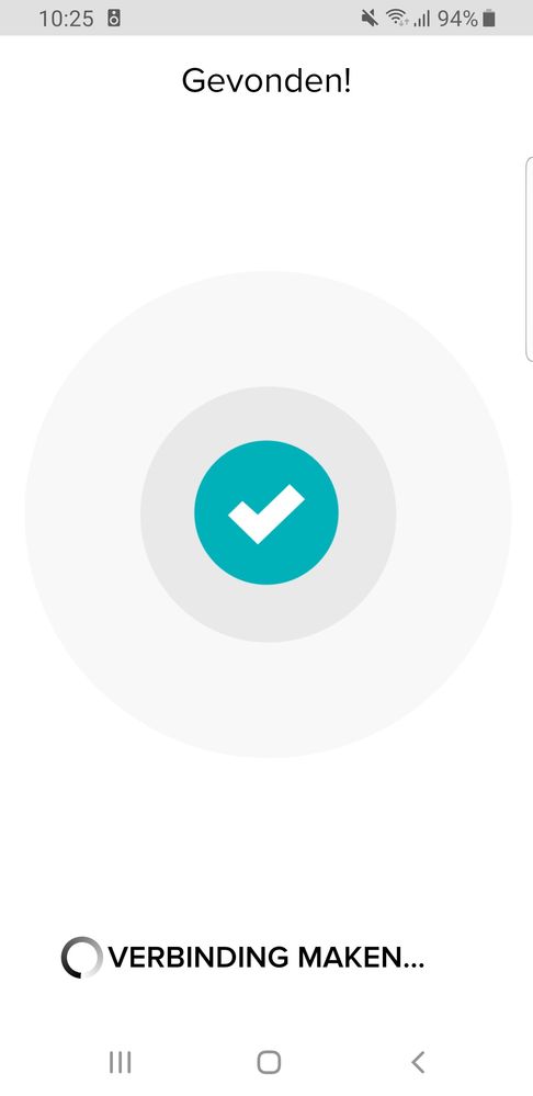

Yes and is does not. So what is the solution? Saying you dont care does not help with anything. \
Here it goed wrong. But this is the part "we dont care"  about right?
No, i tried everything to sync it. When it still not worked i tried to delete my charge from the app.
Reinstalled the app, and than try to connect it again. But i can not add it again. Its getting stuck after the: We found your phone! part.  Also tried on a other tablet, also does not work
Hi @relderson I think you misunderstood me.
A Fitbit tracker may or may not be found by the phones bluetooth, this is normal. A Fitbit tracker con not be connected by the user through the phones bluetooth. You say that you where unable to connect through bluetooth, I'm simply saying that we know,  a user can not connect this way. All setup must be done through the Fitbit app.
As for your screen shot I have no idea what language it is and the best I've found is that verbinding means communication. The checkmark makes me think that it was successful. I assume the setup is what is being referred to.
You should see a prompt to install the firmware.
