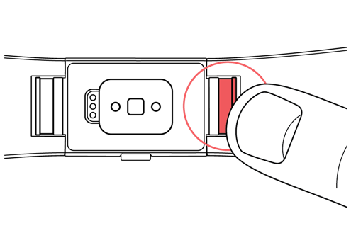

@amslyk thank you for the update. Basically check the metal part of the wristband, there is a metal tab at the end that you can pull to help it better clasp with the tracker. It is the part that shows highlighted that your press when you remove the band but in this case you will pull it to the opposite side while it is removed from the tracker.
