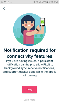

Hey, I get the following message on my Charge2:
I also get the following message on my phone:
Always Connected & Keep-Alive Widget are turned on. I have no problem with GPS or weather on any other apps.
