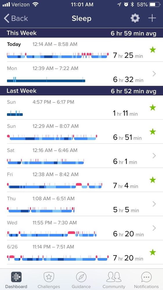

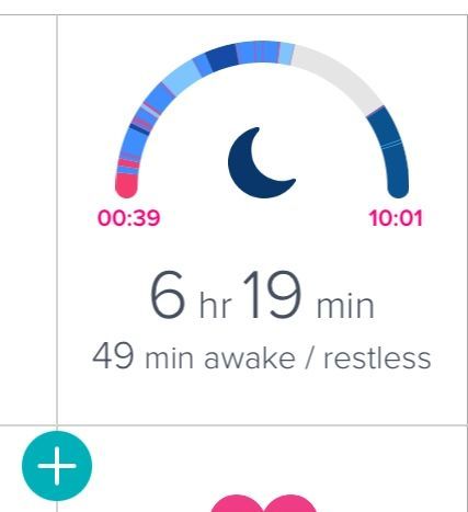

Here’s a screenshot from last night (if I get it right) first with stages, a gap and then the old display !!390423B4-42A7-42EA-B38F-DDC19D8CF034.jpeg
Just to clarify my posting above; the gray gap in the middle is when I get up at 6 am to go shoot at the pigeons that come to my swimming-pool as the sun rises, and at 8 am I go back to sleep for another  couple of hours, after doing a few jobs in the cool of the morning. In todays report the last 2 hours were in the simplified sleep details - what a mix !

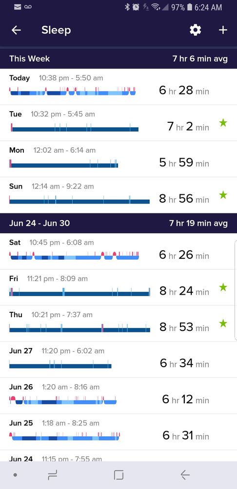

Wearing my versa loose like a bangle bracelet did get me sleep stages last night.  I'll have to keep doing that and see if it works every night.  Screenshot_20180704-062447_Fitbit.jpg
@st8_oftheHeart Since there was a long gap between sleep sessions and the second one was less that 3 hours it would show with simplified sleep graphs.
