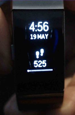

I honestly think charging it is the wrong thing to do. FitBit App on my phone recently updated and after it was update the Charge 2 has frozen. Since I've unpaired mine I can't use it anymore at all. I think this is a software failure. I must remind you that Google bought FitBit last year and this is the first software update this year on the FitBit. Isn't is safe to assume since many peoples screens are frozen, all around the world, that the issue is global and software based?
Here's my tracker, still stuck on the same date when I updated my FitBit App (App updated automatically on my phone during the night). So the first thing in the morning when it synced with my phone it got stuck:
