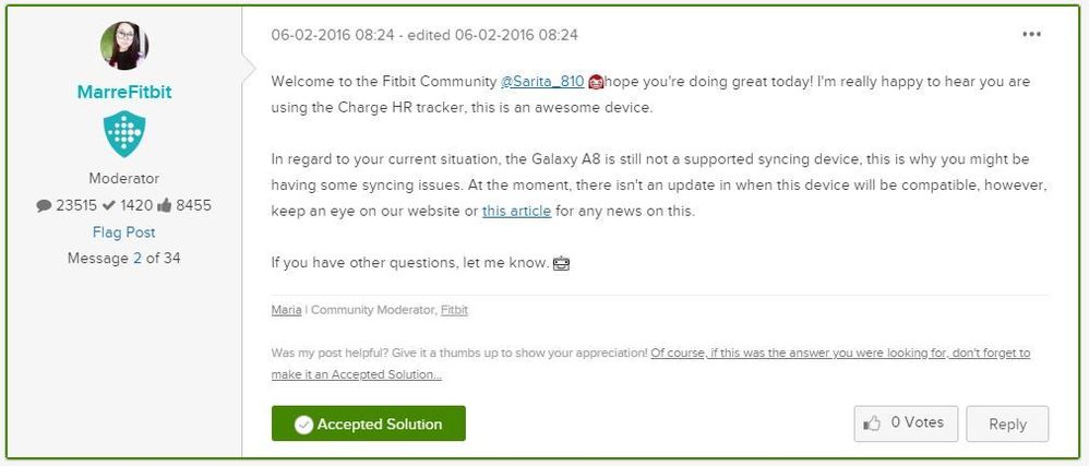

After spending waaaay too much time on trying to get my charge 2 connected again, and reading many many topics about the issue, this is what I found in this forum:Fitbit-Galaxy-A8.JPGThe Charge 2 and the Galaxy A8 (2018) are NOT compatible.
I am deeply dissappointed and upset. To me it feels like scam: I payed good money for a proper phone and I payed good money for what I expected to be a good Smartwatch, with good reviews. I DID check the compatiblity with my phone when purchasing it, on the platform where I bought it.

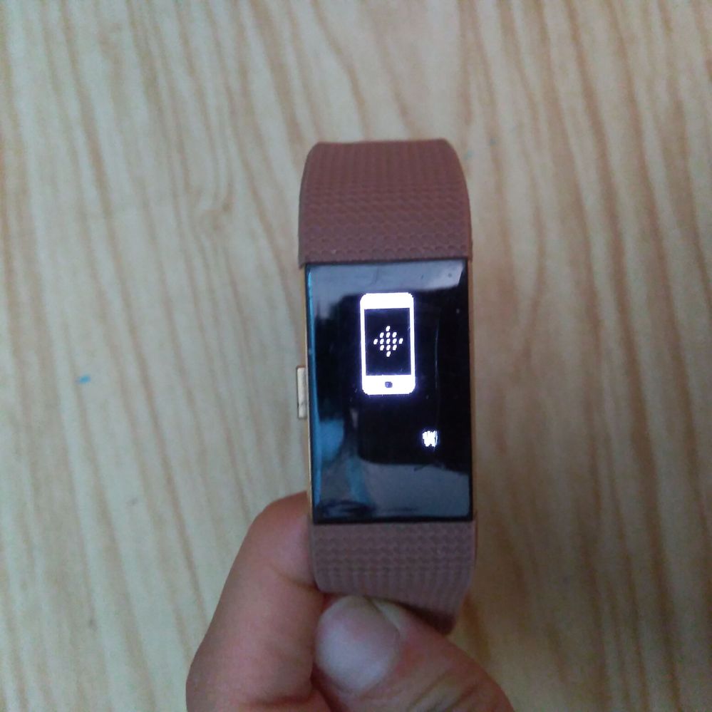

hi, does someone have experience please? everything was ok but today the watches has stoppped to work . i have tried everything above. P_20190805_083944.jpg

Hey Guys,

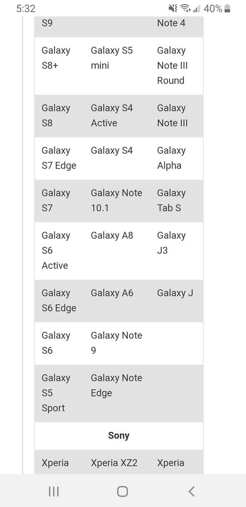

Thank you for your response! They should update their roster because it definitely says that the A8 is compatible. Oh well, time for something new I suppose.Screenshot_20190809-173236_Samsung Internet.jpg
