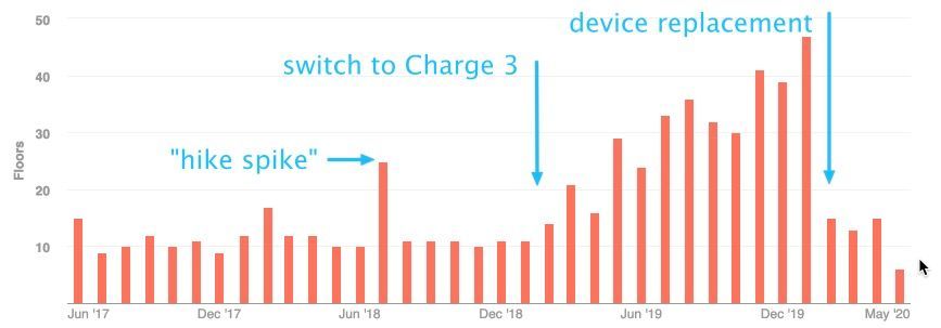

Just FYI:
My Charge 2 worked as expected and gave plausible and consistent readings. Besides a "hike spike", where it counted stairs, when I was actually walking in the mountains, the misreadings started right after changing to the Charge 3. After I got my replacement, all went back to "normal". The image clearly shows the weird increase over time, even if it's showing averages.
