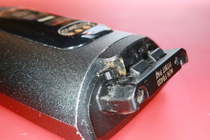

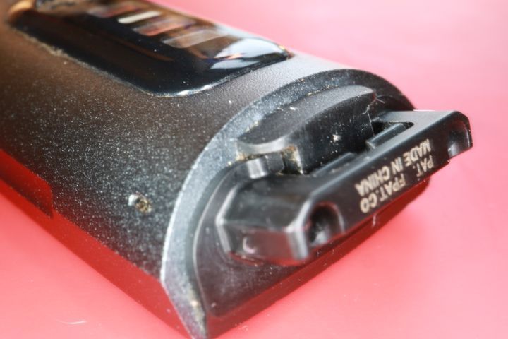

I have the same problem: the button for releasing the band on one side of my Charge 3 is stuck in the 'depressed' position, meaning that the two lugs meant to hold the band in place are retracted and the band therefore keeps coming undone. I attach two photos, one of the end where the button is OK and the other where you can clearly see it's pushed down and stuck. Is there any way to free it up?

Ah. it's OK - I fiddled with it some more and managed to free the button, so it seems to be working again now.

I have the same problem, would you mind sharing how you freed the depressed button?
Thanks!
Hiya, I discovered there was a little bit of grit caught in one of the
clips and I used a toothpick to ease it out. Everything was fine after that.
Hope you get it solved!
Alison
I had to apply a cotton q-tip with rubbing alcohol and clean with a fine needle, then it finally depressed, with the help of tweezers used backwards to push it down, I could then swap my band out. There was build up that needed cleaning.
Mine were also stuck down and new bands wouldn't stay on. Alcohol on a q-tip and a safety pin to pry the button up several times finally cleaned it out and works fine now. I do a lot of dirty work and my fitbit catches a lot of it, apparently off my wrist from below.
Thanks; I did much the same and did manage to solve it, thank you.
Alison
THANK YOU, THANK YOU,  thank you!! Trying to get this one side of the strap off almost made me lose my Christianity. I tried all the suggestions. Yours worked. I only had witchhazel. No alcohol. I applied that with a Qtip and allowed sime of the liquid to sit a while. When the strap finally came off, there was all this gunk in there. I cleaned it real good and my new strap went on no problem.
